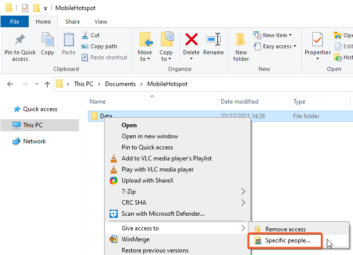

On the computer, you want to share data from, you need to select data/folders that will be shared over the network. Right-click on the folder and under "Give access to" select "Specific people...".
Note: There has to be a user with a defined username and password in Windows enviroment to be able to access the folder from second computer.

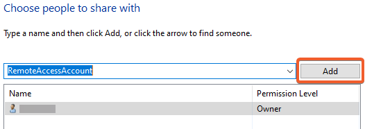

Select the User with whom credentials you want to access the folder from another system and click on the button "Add".
Select account rights and click on the button "Share". You should get confirmation that your folder has been shared.

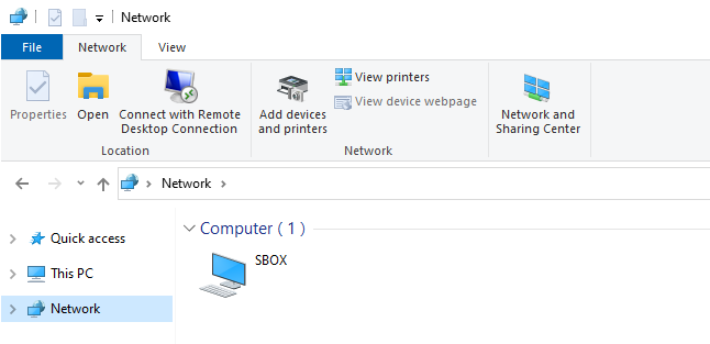

When connected to the same network, the first computer should appear under the network tab in windows explorer. With a double click on it, the login window will appear. Insert the user from the first computer, which you have given access.
In the window, the folders which are shared will appear. You can access all the data in real-time.
