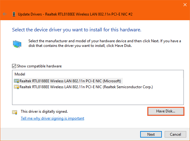

1. Right click on the Realtek WLAN card and choose the "Update driver" option:
Browse the folder to which you have unzipped the attached file and press OK:
From the list of new drivers use the one which is marked on the screenshot: Realtek RTL8188EE Wireless LAN 802.11n PCI-E NIC
After the installation of the driver is finished this is how to check the hosted network support:
