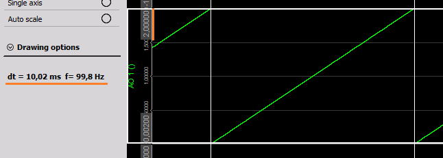

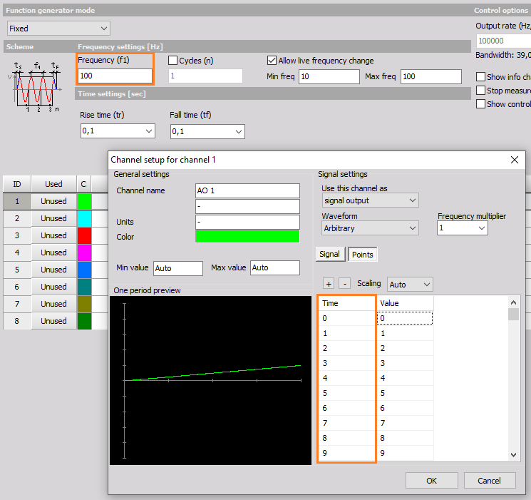

On the image below you can see that the frequency is set to 100Hz and the signal should go from 0-10V in 10 seconds.
With the current settings, the signal will go from 0-2V 100 times per second.

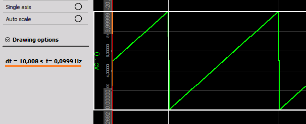

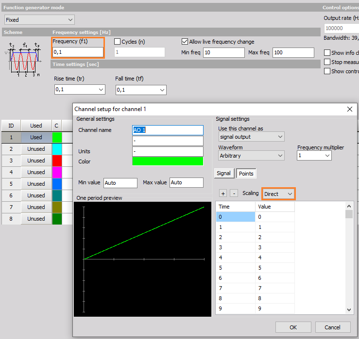

To get the signal that goes 0-10V in 10 seconds, you need to adjust the frequency to 0,1Hz and the scaling to "Direct".
Frequency = 1 / max time in arbitrary
0,1Hz = 1/10s
