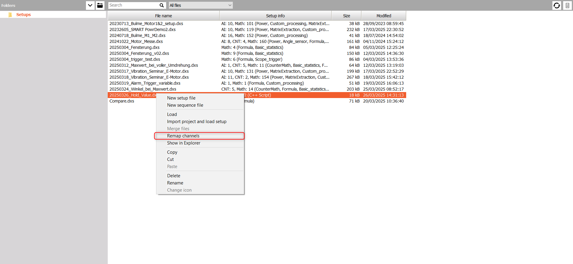

It is also possible to choose remapping a setup by right clicking on it in the setup files grid.
