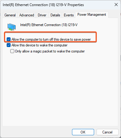

Some network cards come with a setting enabled to Save Power which has been known to cause Data Loss issues when recording within DEWESoft. In the same window as Step 2 go to the Power Management tab and turn off Allow the computer to turn off this device to save power.
