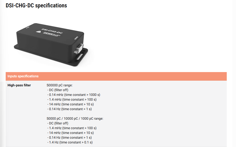

You might have noticed this parameter when looking at the DSI-CHG-DC specifications, where we list both the filter and the time constant, but we do not list them for our CHG amplifiers.

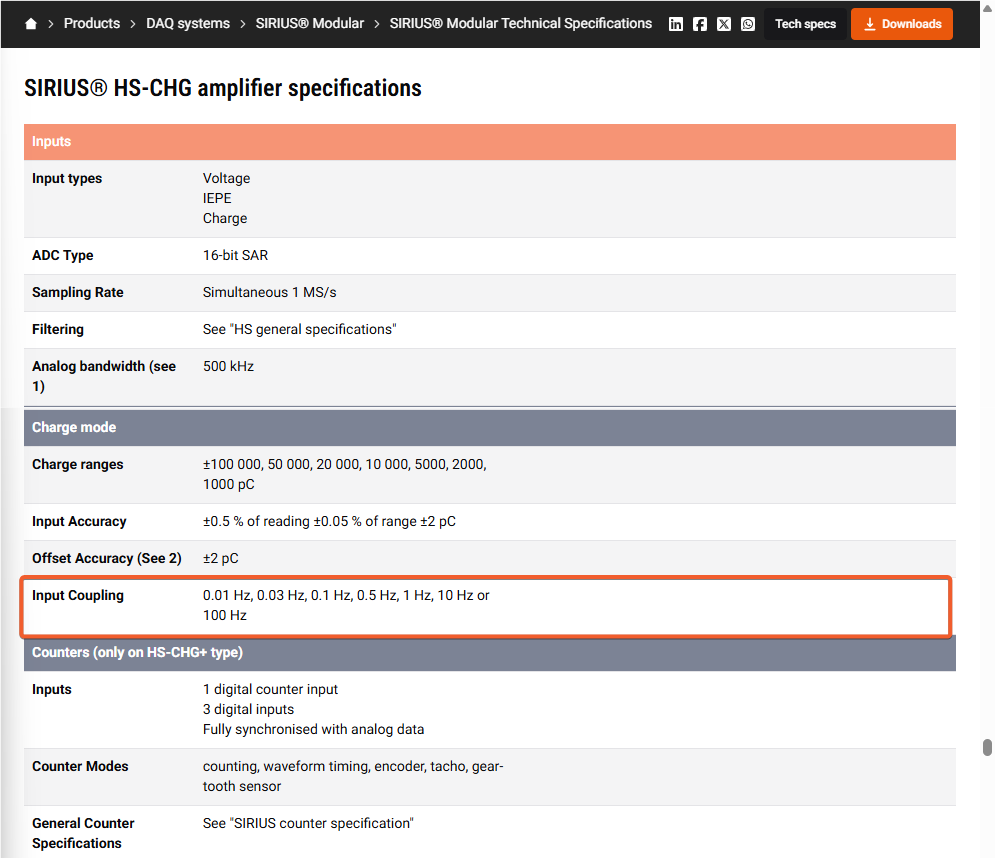

For the SIRIUS HS-CHG, the Input coupling specifications are as follows:
If our Input coupling is set to 0.01 Hz, the time constant will be:
τ=1/(2π * f_c) = 1/(2π * 0.01 Hz) > 15 s
