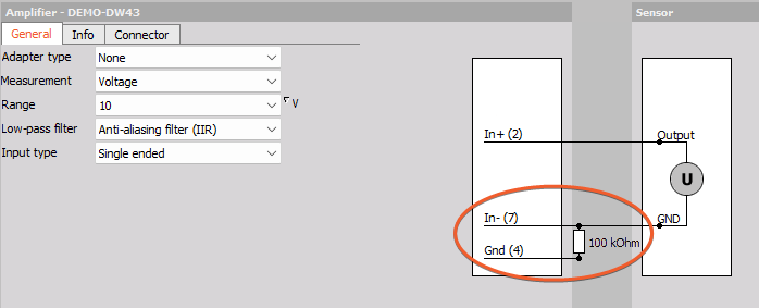

When the measurement is in single-ended mode connection type. Better than 100R resistor is a short between the In- and GND as shown in the images from the manual.
Example:
If the single-ended measurement is used, the Sirius will do a short between the GND and IN- which is the same as shown on the picture.
The DEWE-43 doesn't have this feature, which is why the BNC adapters were made with 100R resistor (IN- -> GND).
From our experience, the measurements have shown better if there is a lower resistance between IN- and GND regarding the noise and interference. 100kR connection is high impedance which can cause interference on the measurement and can cause more noise.
