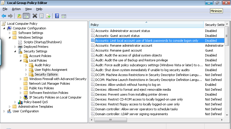

  • Run gpedit.msc
  • Go to Computer Configuration > Windows Settings > Security Settings > Local Policies > Security Options
  • Set Accounts: Limit local accounts use of blank passwords to console login only = Disabled
This will change the default Vista behaviour and allow logon over the local network with a blank password.
