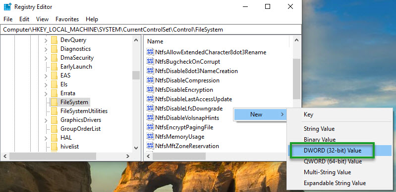

Note: If the registry key does not exist, the entry can also be added by doing the following:
  1. With the FileSystem folder selected, right-click in the empty space of the Name column where the registry keys are located.
  2. Select New.
  3. Choose the DWORD (32-bit) Value, as shown in the picture below
  4. Right-click the newly added key and choose Rename.
  5. Name the key LongPathsEnabled.
  6. Press Enter.
  7. Double-click on the LongPathsEnabled entry to open the key.
  8. In the Value data field, enter a value of 1. This will enable to long paths option.

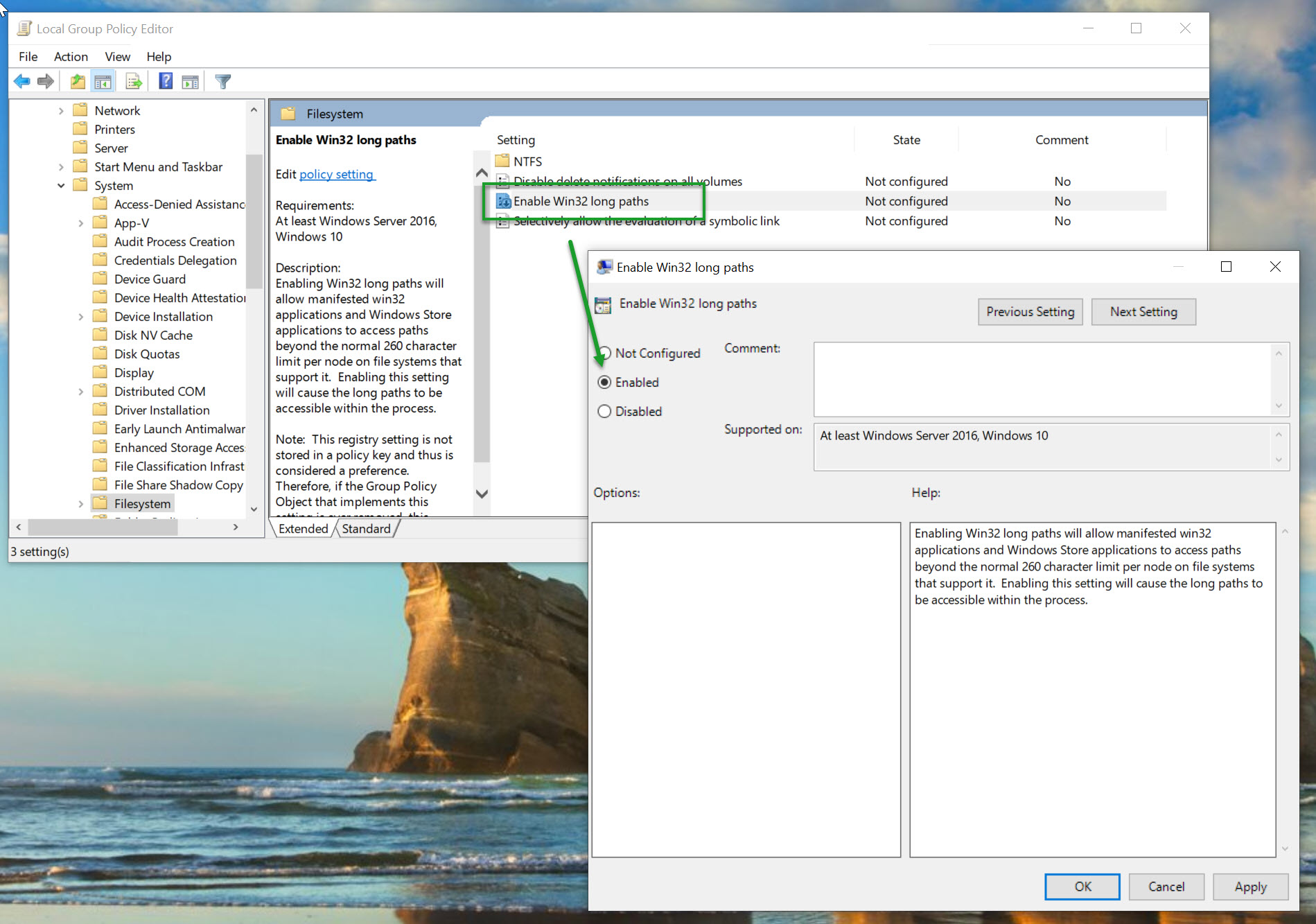

Additionally, the registry key can also be controlled via the Group Policy in Computer Configuration > Administrative Templates > System > Filesystem > Enable NTFS long paths.
