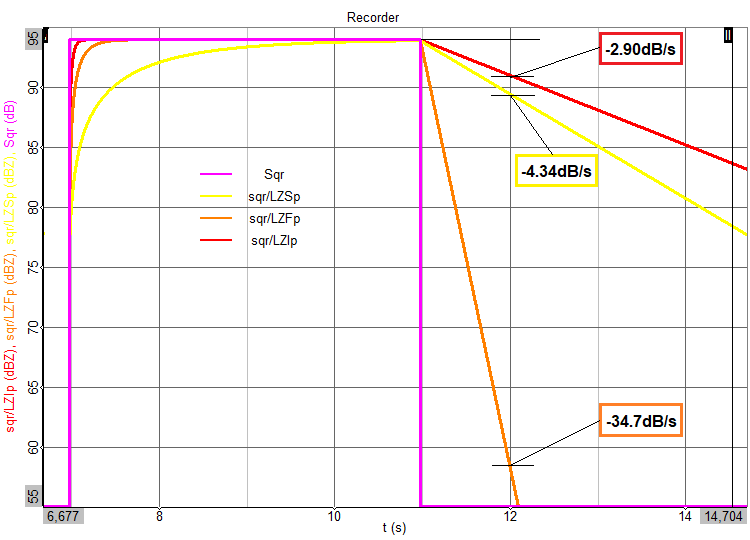

Tau is the decay or rise time constant, that describes how much the data will be smoothed. The greater the tau value the more the data will be smoothed out across time.
  • Fast (F) has a rise and decay time of 125 ms.
  • Slow (S) has a rise and decay time of 1 second.
  • Impulse (I) is asymmetric and has relatively quick rise time of 35 ms and a relatively slow decay time of 1.5 seconds.
Exponential energy averaging
Normally when using tau equal to 1 sec  then that relates to having a decay rate of around 8.7 dB/s, but for Sound Pressure Levels (SPLs) it is only the half (4.34 dB/s).
This is due to SPLs are based on averaged values in the 2nd order (squared) energy domain and therefore exponential averaging is also applied on squared sound pressure values (proportional to energy).
Exponential energy averaging effectively gives a tau value equal to 2 times tau for the final averaged sound pressure values represented in the 1st order (linear) domain.

Decay Rates
The decay rate is typically represented with the unit [dB/s], but is can also be described as [%/s] which expresses the percentage of decreased influence for values at specific times per second.
As mentioned above exponential energy averaging on linear input values will result in a doubled tau time for linear output values:
If we want to express the rate per second then the time t is set equal to 1 second.
Hereby the percentage rate of decay per second can be described by:
In the same manner the decibel rate of decay per second can be described by:
For example, for Exponential Slow (S) averaging the rate is -4.34 dB/s and -39. %/s, for output values in the linear domain.
