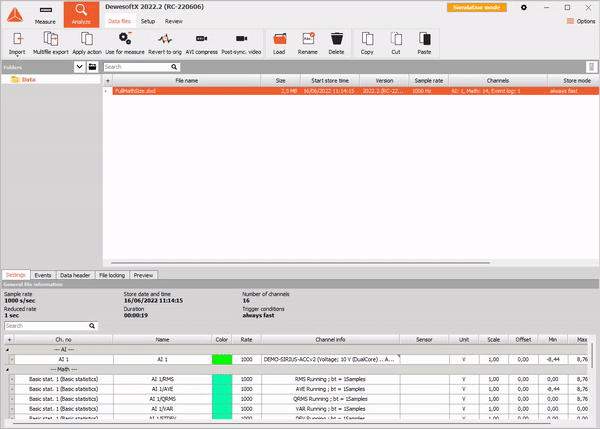

Data file reduction in size
When a user would have deleted a math object from a data file, the data file size wouldn't change. With the use of the new feature Reducing size of the file, the additional not useful data is removed and the newly exported file is smaller in size.

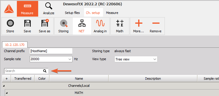

Search-box in Dewesoft NET
A search-box window was added to the Dewesoft NET module, making handling a large number of channels significantly easier.

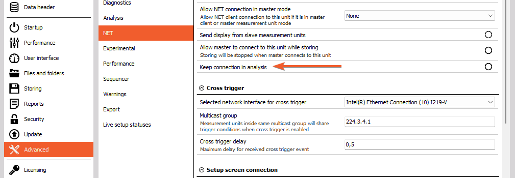

NET connection in Analysis mode
Dewesoft NET module gained an additional advanced option to keep the NET connection when the user is in analysis mode. Now there will be no more pop-up windows that require reconnection.

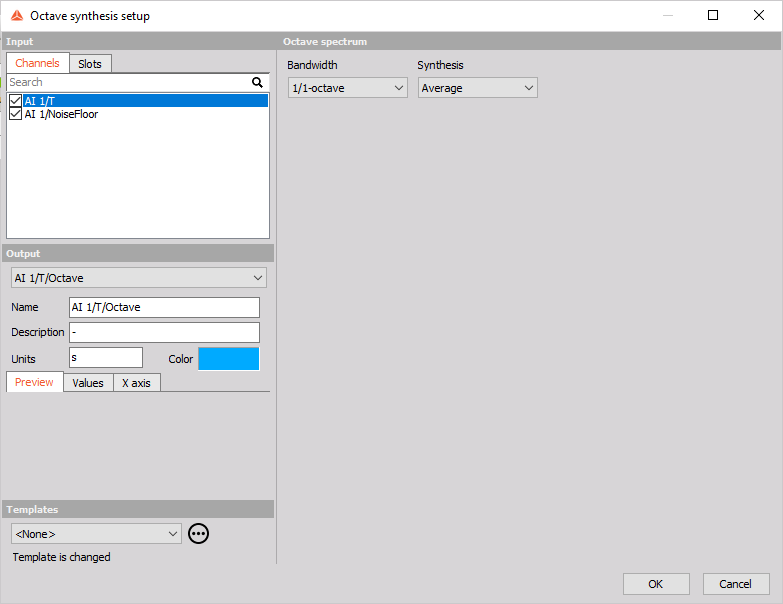

Octave synthesis plugin
New Octave Synthesis math was added, allowing you to easily obtain octave spectra in selectable resolution from 1/1 to 1/24th octave from any narrow band spectra, like FFT or Transfer Function, assigned as an input.

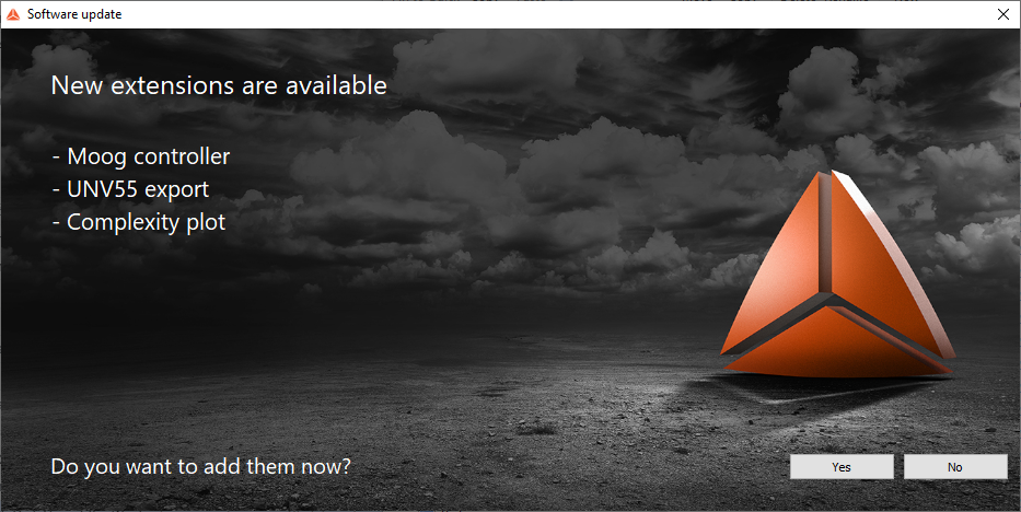

Upgrade new plugin window
When upgrading Dewesoft X, clicking "Yes" on the "New plugins available" window should automatically select them for installation.
