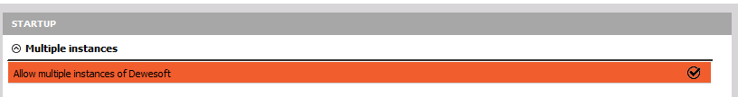

The following instruction shows how to enable multiple instances of DEWESoft exe to run simultaneously on the same machine. While on pre-Win8 OS this is straight-forward:
- enable the option in DEWESoft (under global settings),
- disable UAC (Control Panel > 'Change User Account Control settings') to allow Plugin registration.

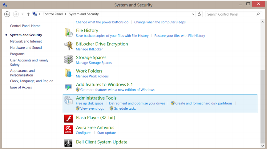

On Windows 8 and higher additional step is needed that prevents running admins in 'Admin Approval Mode'. First, go to Control Panel > System and Security > Administrative Tools:

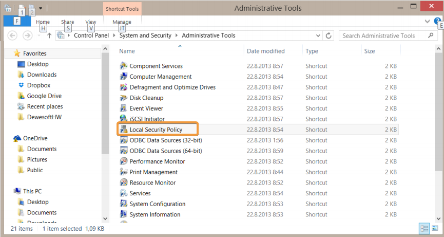

Go to 'Local Security Policy':

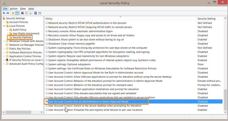

Under 'Security options', disable following: »User Account Control: Run all administrators in Admin Approval Mode«:
That enables plugins to be registered in all instances of DEWESoft.
